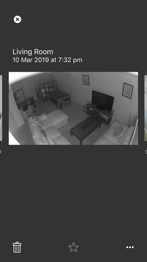

Hi, I have several recipes that are triggered by smart home products (ring bell, door sensors etc) that generate IFTTT triggers. However, although the recipe runs, nothing seems to be recorded by Arlo. At least I cannot find it back in the Arlo library. But when I look at another video and swipe to earlier recordings, there is something there but looks like it only recorded a picture... Anybody any thoughts on why it shows this behaviour and does not seem to record video images? Tx,

I’m having the same problem. It appears when using IFTTT they don’t show in the library until you select another video (that was created by Arlo motion, rather than IFTTT) and then swipe you can see the IFTTT generated one. However no play controls and just a still image. So it seems it’s just taking a snapshot even when you configure the IFTTT rule to record video. This started happening in an iOS update for me) sometime in January. Support have no idea and just go through level 1 troubleshooting advice (FYI I did it all and even created new Arlo and IFTTT accounts and tried another phone) So now I’m just hoping a future update will fix it. 😞

@JohanC @Foil   I too am having the same exact issue.  Had IFTTT triggers set up and working perfectly up through Jan/Feb.  With third party devices triggering video recording with my Arlo Pro cam.  It does seem to be a issue after an iOS update.  If you try to playback the IFTTT videos on desktop or Android devices,  it would work fine.  Another workaround is if you filter your library on an iOS device (but only to see the thumbnail and hear audio).

Looks like the last iOS update release a day or so ago didn’t fix it. I’ve tried uninstalling and clearing the library etc (all the steps support has previously asked me to do). So IFTTT triggered recordings do show up if you set the filter to show them and still no play/stop controls like a still image. However not sure if this recently changed yet I can download the still image to the camera roll and it will play as a video. Weird. So it’s recording properly just the app is still broken when it comes to being able to play them?!
