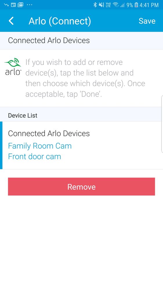

Running Smartthings and Arlo app on Android. Firmware for base station is 1.15.1_3092_d878851. Pro 2 cameras show up as Smartthings devices but not the base station Siren. Would prefer to sound the siren based on a door sensor or window sensor. If Smartthings cannot see it as a device then it is not that useful to me. Is the siren not showing up in Smartthings the normal situation?

I was told by Arlo Support that this base station (VMB4500) siren does not show up in SmartThings as a device. Based on posts I have seen about the previous base station (VMB4000) that siren does show up in SmartThings as a device. I would hope this is an oversight and will be corrected. I would rather my base station be fired from a door opening anywhere in my house rather than waiting for motion to be detected on my camera. Hoping for a reply from someone from Arlo as to why not.

Yes, my original post states that is the firmware that I have installed. Can someone tell me why this base station does not show up in smartthings? Was that intentional? Why would you have the VMB4000 show up in Smartthings and not the supposed newer release of the base station. Here is why it does not make sense.
Suppose someone breaks into my house through the front door or the basement, wouldn't it make sense for me to fire the siren from a door sensor vs waiting for the motion detector on my camera to pick up the intruder when they get up to my family room. By that time the intruder will have cleaned out my basement and everything in my upstairs. If he never walks into my family room no siren.

Do you have a screenshot that shows VMB4500 is not showing up as a siren in Samsung SmartThings?

A friend of mine has the VMB4000 that he kindly let me borrow and it works great. When linked to SmartThings a new "SmartThings" mode appears in the Arlo app and the siren shows in the SmartThings app. Unfortunately, when I connect my VBM4500, this is not the case. A SmartThings mode does not appear in the Arlo app and the siren does not display in the SmartThings app.
