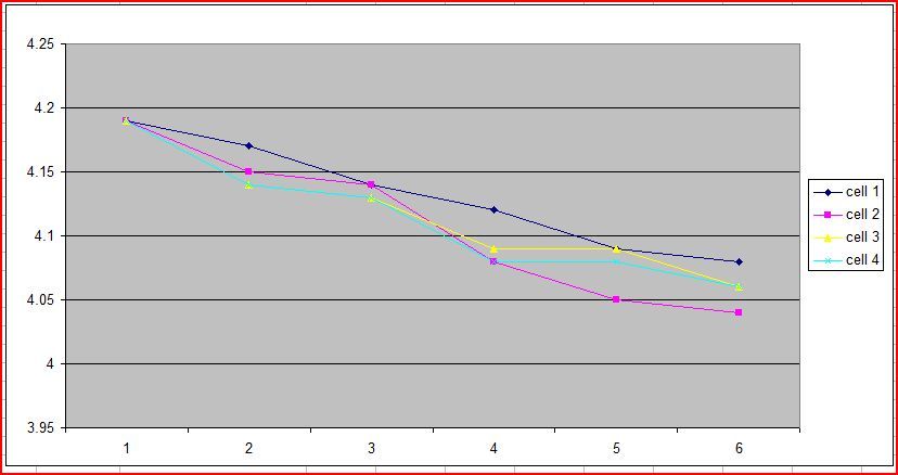

TomMac
Tangsfire cells running good , so far 6 days data.... not enough ovb to make any type of call, but cells doing nothing abnormal.
They are following curve like others tested so far ( which avg 40 days ) but things change fast with rechargables.
Also a note these are the first run of cells and tho fairly matched, not what I would call seasoned ( 2-3 full charge/ discharges ).
Chart so far;
