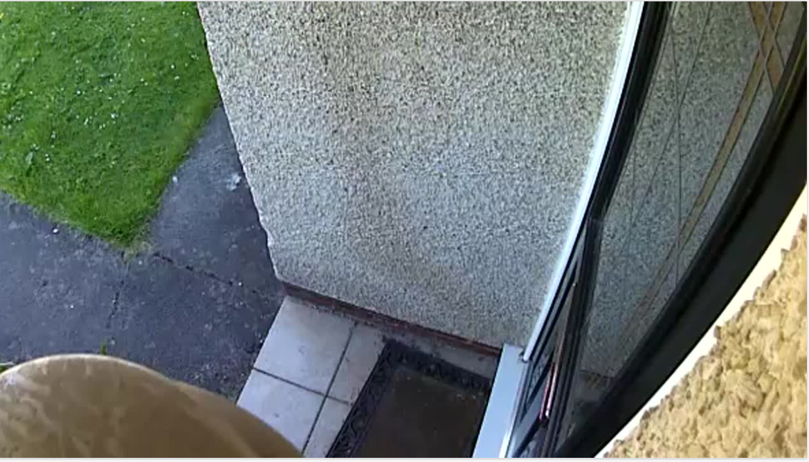

The screen shot is below, pretty dull view TBH, no traffic or pavements near the camera

Couple of things:
1) The glass door could be reflecting IR. The angle is pretty severe, though, so maybe not.
2) Are you changing sensitivity in your modes? If not, you're not really changing it. In Settings, it doesn't save.
If everything is ok, remove the camera in Settings, My devices. Reinsert batteries, making sure the blue LED on the front flashes to indicate power. Resync the camera. Any help?
