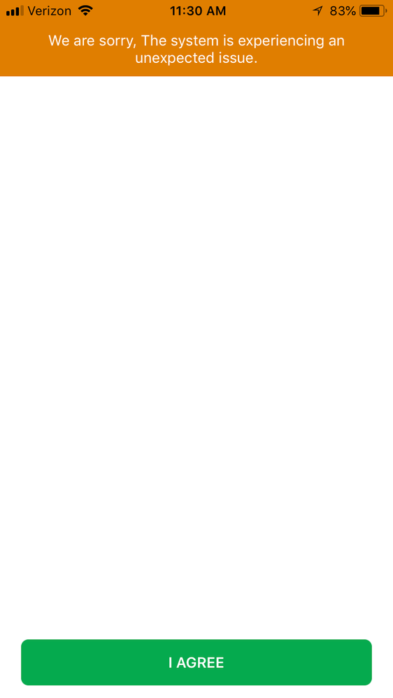

This error has been at the top of my iphone app for a few weeks now. I have had the system for 2 years without this issue. I have 2 base stations, an arlo go, and a Q. The error eliminates my mode button in the app. I can only change the modes using my computer. I just bought a new base station with the siren to replace one of my base stations. I have 10 cameras total. Need HELP as I have exhausted all the typical shutdown, restart, reset options. I really don't want to start over with another company.

If you're able to change modes on your computer, this isolates the problem with being specifically with your iOS devices or the iOS mobile app. Do you get the error message as soon as you log in to the app or does it only happen after the app has been idle for a period of time? Is this an intermittent occurrence or do you always experience the error message when you are logged in to the app?
Error message is at top of screen on all 3 of my iphones and both of our ipads immediately after login. I can click down at the bottom and the message goes away, yet the mode button never appears. The mode button appeared one time shortly after I first noticed the issue, but that was for one login and then it disappeared again.

Something else to note...within the app and under the Account section, there is a line that says "getting information" and no way to click on it just above the "profile" line. I thought there was a button there that one could click to modify account info such as payment info.
Using the computer, under the settings tab, the account button is not clickable. I can't find anywhere that one would click to update payment info.
Ok, I just logged in to my account using my brother's android phone and everything looked and functioned normally. I noticed under the settings tab, it said "subscription unkown". I clicked on this and got the error I am getting on my iphones. Do I have some sort of subscription that was discontinued and the system is jacked up as a result?

I can still at least change the modes using my desktop computer. I just can't do it via my phone(s). I was using the geofencing, but that doesn't work seems how I don't have a mode button on my phone. I would expect that some sort of an update would have fixed it by now, but nothing....... I can't even get to my subscription so I can update that. I guess once my year is up, I throw all this in the trash and start over with someone else.
I just deleted it off all of my devices and reinstalled it only on my primary phone. Still jacked up. Error and no mode button still the issue. Let us know how the Ring thing works. I already have 3 of their door bells.
