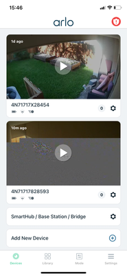

VMB3010r2 Poor Video
One of my Arlo cameras suddenly has consistently poor video quality in both live mode and recorded mode. It’s become basically unusable. It has fresh batteries at 90%.
3 REPLIES 3
Can you describe the issue you have, all I can see is a faded yellow triangle with a black border, guess will need to wait for it to appear unless you can describe it.
Assuming the bottom thumbnail is the one at issue, the usual suspect is signal strength/quality. Try moving the camera closer to your base to see if that helps.
Maybe swap the two cameras, and see if the problem moves with the camera, or stays with the location.
