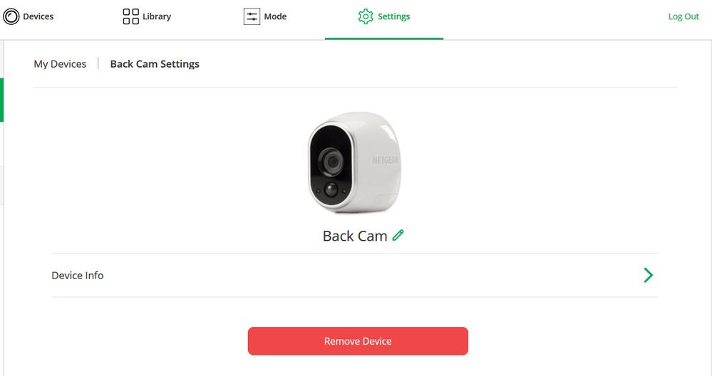

Sure, no problem, exactly, the On / Off switch is no longer there, as I said. Fresh batteries, sure, but that means to sync again, so of course will make the issue go away.
Anyway, here is what I see from computer, as the Manual says, go to Devices -> Settings
Tap the the Camera On / Off
Your screensot shows that the camera is offline, hence no On/Off switch. If the batteries are good, then there are a couple of things to try. Start with rebooting the base. Then briefly press the base sync button (don't hold it for 2 seconds) and then press the camera sync button. If that doesn't work, remove the camera from Settings, My Devices and resync as above.

I sync the other camera, here is what I see now. As I stated in the original post, this is information for people with the same situation in the future. I can only assume the camera is OFF for too long or lost connection, so ther is no option to turn ON, only way is to re-sync. Thanks for the help.
