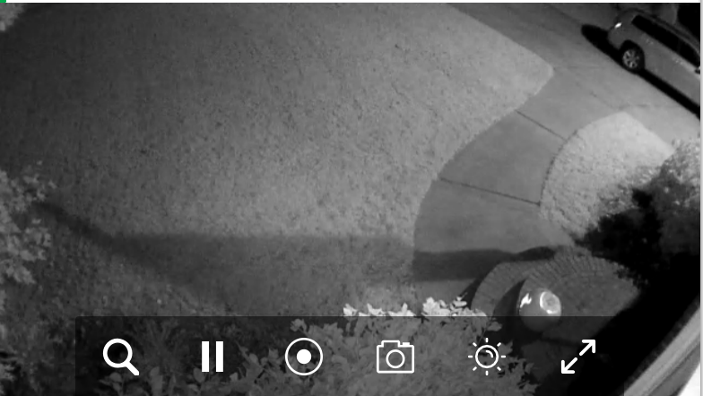

I did just now remove from smart and attached is the front door view.
here is the garage view
The front camera is awkwardly placed. Much of the motion on the sidewalk is directly at the camera or nearly so, making detection difficult. I'm guessing you're using the magnetic mount due to the angle - I'd suggest using an outdoor one that extends out and swivels so you can get a better view but I'd be looking at putting the camera on the other side of the door.
The garage camera has the same problem with motion directly at the camera. I think the same suggestions above might help, moving the camera to the left side of the garage (as seen looking towards the front of the house).
