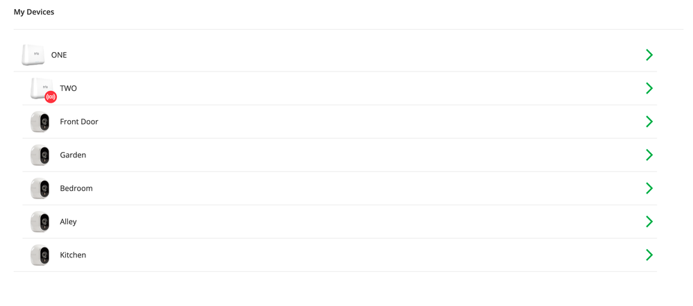

I had factory reset BASE TWO & this was then connected to the wifi-extender with a cable, plugged in switched on & shows under my devices - even though its the wrong picture. See PIC A attached.
All I can do when I select BASE TWO is change its name, it does not offer me any other options unlike when I look at BASE ONE.

I think I get it now - sorry for being slow. From your picture A above when you restated your issue, it shows two bases labeled ONE and TWO. Two isn't a base - it's the siren for the Pro base. It's there so you can relable it to something that makes sense to you if you have multiple bases with sirens. That's all it is.
You need to claim the VMB3000 using the Add Device selection in the Devices tab. Once you do that, remove the appropriate cameras from the VMB4000 and sync them to the 3000.
