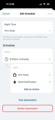

Sorry for delayed response. I’m about to buy another brand. I’ve never been so frustrated with a software interface.
That said, another attempt using screen shots (thanks for tip)..
You apparently ignored my comment above on the enable lists. Both should be set to "Arm Away, Arm Home".
You are telling the system to run "Night Time" only when the system is in "Arm Away". And of course the point of the automation is to switch the mode to "Arm Away". So the automation has no effect, since it only runs when it is not needed.
The same defect is in "Daytime".

Well, the problem is that you set the enable list incorrectly. Hopefully the info I posted above on exactly how it needs to be set will help.

I suspect you didn't understand, then. The selection just below the automation's name is the issue. Instead of selecting only Arm Away or Arm Home, leave them all selected so the section then changes to Always Enabled. Additionally, in the Then section, use Change Mode to select Arm Home or Arm Away.
