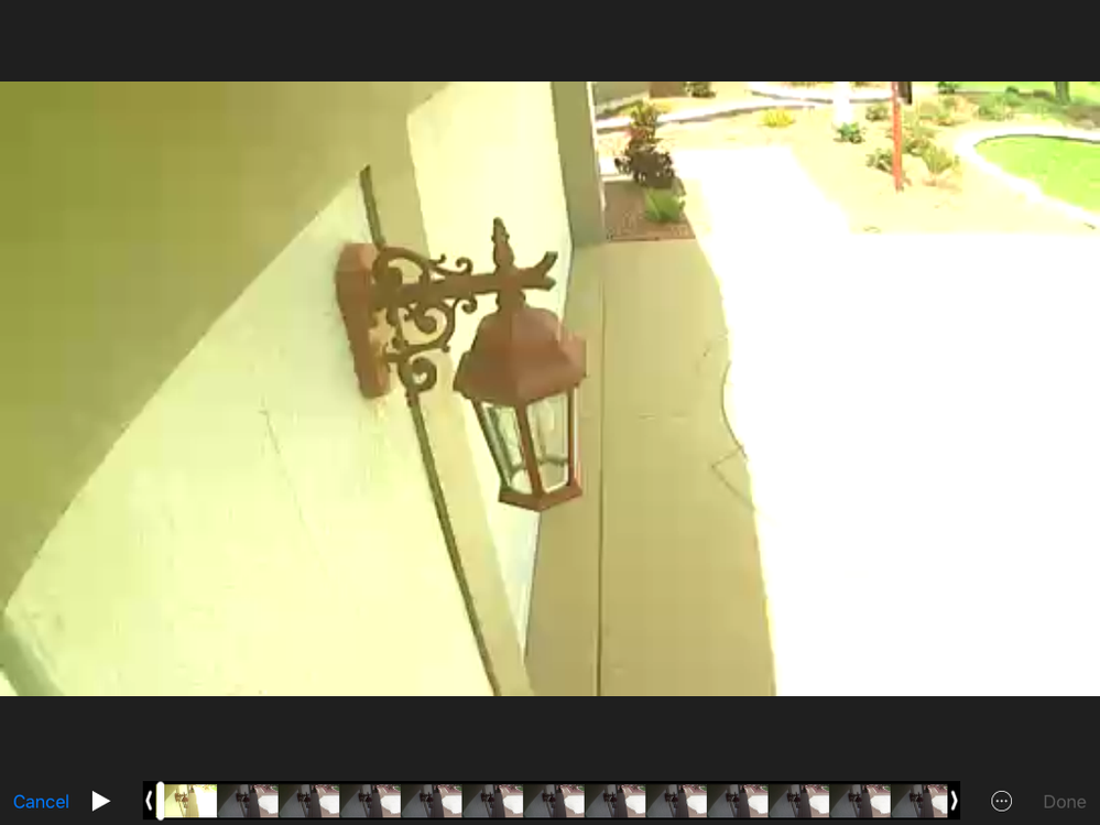

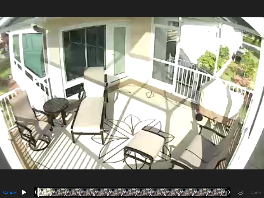

That nails down IR from the sun. Are you changing motion sensitivity in your modes and saving? Use of the Motion Detection Test doesn't change anything - it's just a number to use in your modes. Post screenshots of the camera view for suggestions.
Attached is one of three
Attached is the second of three.
- Attached is the third of three
That's a lot of sun! 🙂
However, I don't see leaves/branches/trees that would be my first items to exclude from the view. Are there flying objects (birds, insects, airplanes) that might be causing shadows or flying quickly through the cameras' sight? Don't forget that the cameras take a couple of seconds to start recording so somethng could have moved on by the time you get the start of the video.
