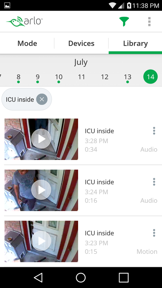

The latest gap was from 6:27pm on Jul 10 to 9:23a on Jul 12. It has now stopped at of 5:18p today (Jul 12 -- it is 6:30pm)
Current screenshot of one of the camera history:

Thank you for the screencap Alicia.
Interestingly, your gap aligns with mine (can you check the date of the last recording on 7/10?). This may point to an outage on Netgear's or Amazon's end (they use AWS for their cloud service).
