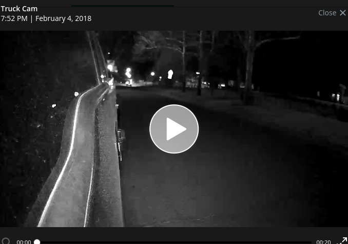

Here is the example. This camera is mounted on the outside driver mirror on my truck, looking backwards along the truck. This camera was triggered by a second camera that is looking at the road about 20 feet in front of the truck.
See those tiny little tail lights in the distance of the car that drove past?
This is the first frame of the video. It is useless to create a mode like that. If i use the Truck Camera as recording AND Trigger, then the passing vehicles are caught MUCH sooner and are usually JUST past the truck when the recording starts. In this example the passing car was already 300 feet down the road! That is useless and does not work as intended!
I have another trigger camera looking BEHIND the truck and it's the same problem. If I use the Truck Cam as trigger and recording, it just catches the tail lights of the passing car before it is out of sight.
What I WANTED to do is to trigger the Truck Cam by the camera BEHIND the truck so that I have full view of the passing vehicle while it approaches the Truck Cam's view. This is NOT possible, and I can repeat it at will.
Since you're triggering the truck camera with another, we need to see what the triggering camera sees. That view is what determines how the camera should be positioned.
This is the trigger camera. It looks to the left (behind) of the truck. On it's own it captures vehicles nicely going down the road from either the left or the right.
Interesting. I would have suggested the distance to the road as being the issue but if it works by itself, it should work with the nested rule. Maybe removing the truck camera from Settings, My Devices and resyncing may help (be sure to readd the appropriate rules afterwards) or possibly a new mode to see if that helps.
