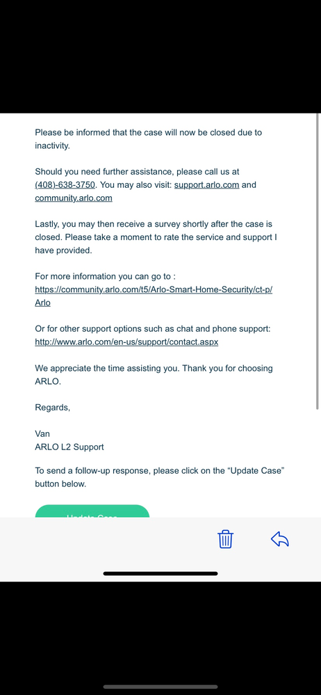

Case Update
Thank you for contacting Arlo Suppor
Please, perform the steps below and get back to me with an update.
Before troubleshooting make sure that gates 80, 123 and 443 are open on your router.
In that case I will ask you to hard reset the base station. In order to perform hard reset:
1. Using a long sharp object press the RESET button on the backside of the base station for 10 seconds.
2. While still holding the RESET button pressed remove the power cable and the internet cable. Wait 10 more seconds.
3. While still holding the button pressed plug back in the power cable and wait 30 more second.
4. Release the RESET button.
5. Connect the internet cable to the base station and go to Arlo app to re-add the base station and the cameras.
In case of any questions, please contact us.
I apologize for the inconvenience, I have escalated your issue & customer support will be reaching out to you as soon as possible.
