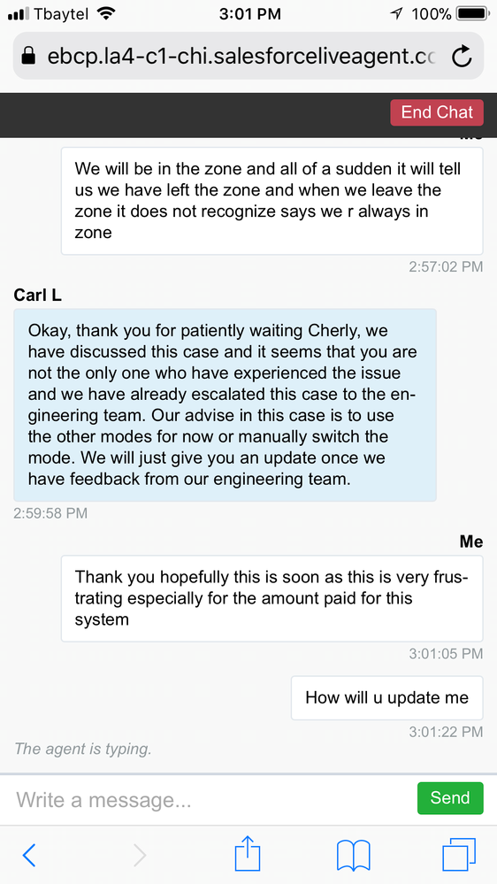

I have geo-fencing enabled such that when I am within the radius, the system should be disarmed. When I get home, the app notifies me that I have entered the geo-fencing area, yet the cameras will still notify me that they detect motion. Broken.
Geofencing does not work for me either (sweden). When I come home the system gives me a notification that I have entered the zone but it does not switch to "schedule", which I have set for "home". If I briefly switch from "geofencing" to something else and then back again it seems to some how update the locations of the connected devises and the mode is set to "schedule" as it is supposed. The same is true when we leave the zone. We are using iPhones.

I've had a ticket open regarding intermittent geofencing performance for over a year now, with no resolution. It would work maybe 40% of the time before the latest "update." While this complete failure to work is new, the lack of response from Netgear/Arlo is not. They apparently have more resources dedicated to new product development than they do maintaining their products because they sure like sending me emails regarding new products (ex. baby monitors). I am not sure if they are aware it is their job to make their devices work with the phones, not the other way around. Dear Netgear, in case you are not aware of the obvious, Apple is not trying to sell us Arlo cameras, YOU are. It is YOUR job to make it work with the phones.
