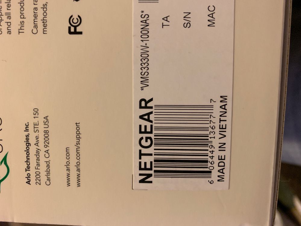

I am having the same issue with the model VMS3330W that I just bought. It finds the base, I can name it but it acts like the connection to the server is not working.
No Arlo Device Found. Checked in the router to make sure connection is found, lables the device in the router, rebooted router all to no avail, so much for a good dark thursday find.
