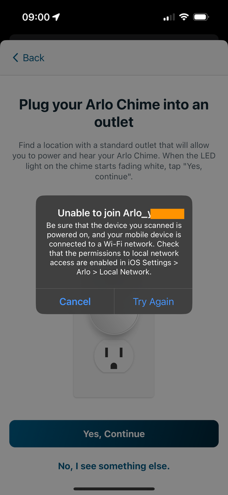

Tried over and over and now I can't even re-associate the Chime 😭
I obviously tried a few things, no success

- It still does not work, and I now see that there's a widespread issue with this Chime (see: https://community.arlo.com/t5/Arlo/Chime-2-IOS-Apple-setup-error/m-p/1937965)
