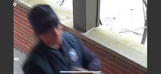

Here is the zoomed in image. I have tried this again and again, zooming on a person who is within 5 feet of the camera makes their face completely unrecognizable. Is something wrong or is this what Arlo delivers?

So for testings sake I enabled the 4k plan. 6 feet from the camera, middle of day, my nice mail-person walking at a normal pace, you cannot make out the face if you zoom, which you must do to see their face. Check out the screen grab.
This abysmal quality is on an iOS device as well as with the downloaded 4k video on a desktop. No difference.
This product is an absolute fail, as a security camera the Arlo is completely useless. Am I being completely unrealistic in my expectation that a wireless camera should be able to clearly show a face of a person less than 10 feet from the camera in broad daylight? Perhaps I should have known better?

After reviewing the clip, I don't see anything out of the ordinary with the image quality. When trying to identify specific details (license plates, facial features, etc.) many environmental conditions have to be considered. The subjects distance from the camera, how fast they are moving, the angle and positioning of the camera etc. all factor in to how discernible these details will be. In your environment, if your objective is to capture facial details for subjects at your door, lowering the camera and adjusting the angle might capture a better clip for discerning these details.
StephenB
The lighting is definitely a factor, as the outdoor sunlight is backlighting the area of interest.  The outdoor views are washed out as a result.
What details were you hoping to see better?  The mail (and the carrier) are generally moving throughout the scene, and as a result there is some blur on both.  Some of that might clear up if there were a higher bitrate used, but some of it appears to be the normal motion blur that you'd see at pretty much any bitrate.
When the carrier reaches the mail slot at around 5 seconds in, the reduced motion does result in an increase of the amount of detail.  There are a couple of frames where you can see the benchmark logo printed on the top piece of mail quite easily.  Of course in the others it is either too blurry to read or hard to see because of light reflections.
I agree with @JamesC that the image quality looks fairly typical for the camera.  Lowering the camera would give you a better look at people's faces.  Moving the camera to the other side of the door could help with the backlighting/exposure problem.  Though my own front porch cameras are also a bit high (there's nothing to mount them on lower down).

Thanks for overlooking my crankiness and giving me this useful feedback. I have not had a wireless camera system so I was honestly not sure if mine was operating correctly or not.
That makes sense about the lighting- I can move it to the other side to get better conditions. I also realize that when the person is closest to the camera, they are crossing its field of view at an angle, so I will try and position it so the person is more straight on to the camera. There is a lot to like about the system (the notifications and activity zones work great) so I will try and optimize the placement. Ideally I’d like enough of a face to share with police as our area is known for porch pirates.

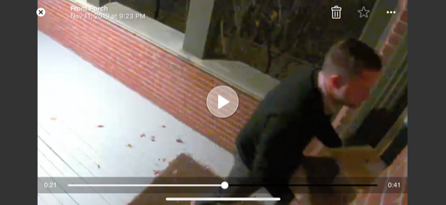

Today I recorded a porch pirate coming on to the porch after the mail had delivered packages in our neighborhood. He looked and saw the camera and tried to whack it off its mount. Caught him perfectly and the very distinct jacket he had on. Cops saw the video, said it’s a perfect shot of the guys face, he matches a description of a trespasser several of my neighbors have given to them. Luckily they also know exactly where he is, not his first time evidently.
All I can say is boy was my first reaction wrong. Again, thanks and I will definitely recommend this product to anyone looking for a simple home system.
