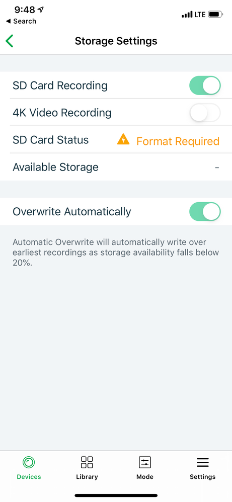

The other problem I am running into is not being able to use the microsd card slot on the hub. I purchased a Samsung 256GB 100MB/s (U3) MicroSDXC EVO Select Memory Card to use with the hub and put the microsd in the slot but the app is telling me "Format Required" with a warning sign (triangle with lightening bolt). I looked on the microsd card and there is nothing on the card so its not like there is something that needs to be erased. Is this a known problem? And how do I format the card to the smarthub's liking?

The format is required to be FAT32. It's very likley that the format on the card from the factory is NOT FAT32 but maybe exFAT, NTFS or ext4 due to the card capacity. It's actually hard to format FAT32 on a computer with a card that size so let the base do it.
I would gladly let the base dow it but HOW do I get the base to do it? I see no option for that
In your app, go to Settings > My Devices and select the base. On the Device Settings page scroll down to Storage Settings and select that. On the Storage Settings Page scroll to the bottom of the page and click on the red button that says Format SD Card.
Brian
I see your problem. You are missing the whole bottom portion of that page. Although the base seems to see your card, it appears that it does not recognize it. We will look to find other ways to Format your card to FAT32. I am going to google it.
Brian
Wait! I loaded up the portal on my desktop and was able to find the format button. It is formatting now. Thanks everybody for all your help. For some reason the format button does not show up on the Iphone App. Note to the Arlo programmers lol.
