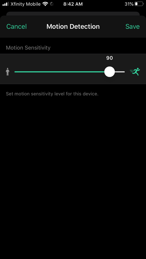

On all my Ultra cams. Anytime I adjust the sensitivity it resets back to default 80% a short time later.
Go to the “mode” tab, choose your hub, click the edit pencil on the right, hit the edit pencil again, then a third time. After you move the sensitivity slider the save button will appear.
5 REPLIES 5
Where are you changing the sensitivity? The setting in the motion detection test is only used for testing. If you want to change the operational settings, you need to go into the rules in the mode(s).
https://kb.arlo.com/42/What-are-modes-and-rules-and-how-does-Arlo-use-them
Interesting. Thanks. Yes I was changing from the motion detection test.
Are you hitting the “Save” button, top right in the app ?
I don't see a save button on the iOS app. The motion test scale specifically says to "modify how sensitive the cameras are to detect object size and distance".
