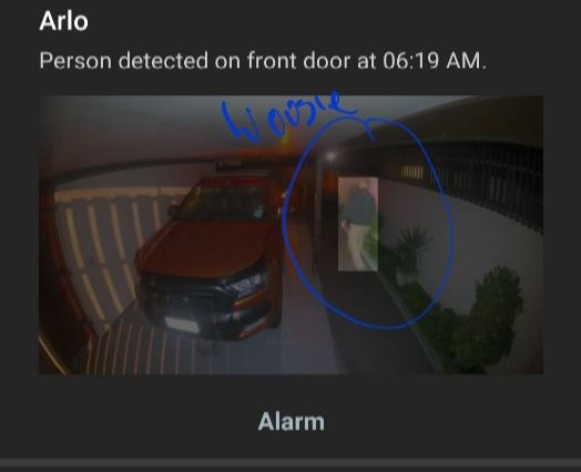

I also like the recent upgrade to the service where it now highlights the area of where the system has detected the motion...that's a really cool feature...Arlo Ultra with the premium
