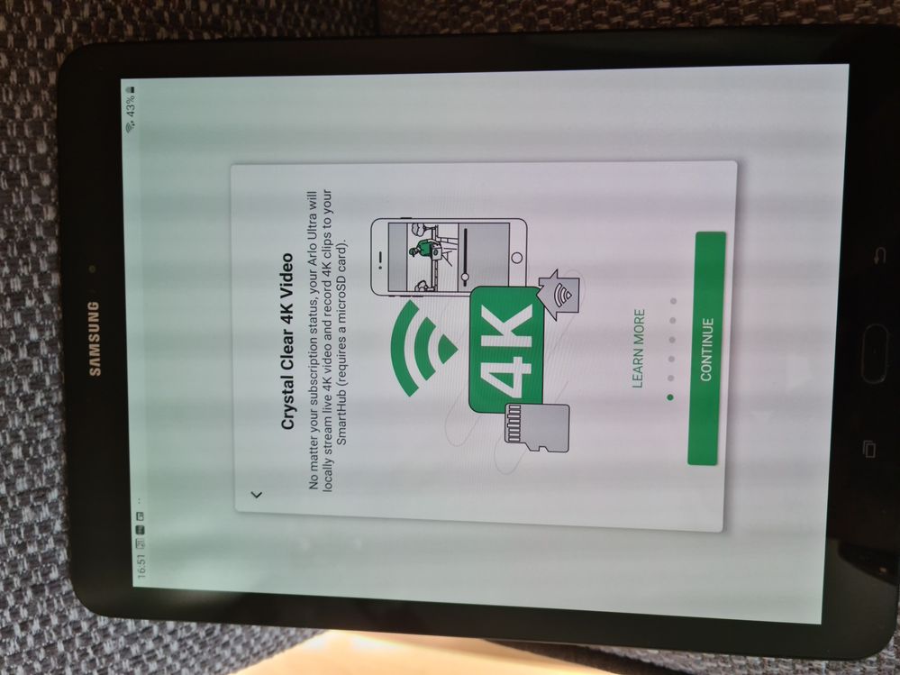

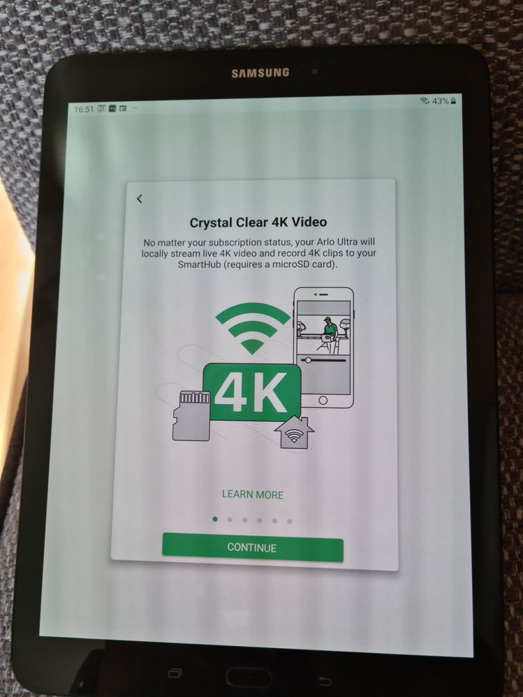

Hi again, I have some news. After emailing Arlo for a second time about this, the first time was asking why I couldn't record in 4K to my hub. The second complaint was about the reply I received. This time they apologised saying they didn't realise I was talking about recording in 4K to my hub and suggested I try removing the 2 hubs I have and reinstall everything from scratch. Which although sceptical I did this yesterday. After getting everything up and running I can now report I am getting 4K recording to my 3 cameras as well as no blank screens when trying to access the cameras live 4K. It has worked overnight and again seems to be working today. The only niggle I have now is when trying to access the recordings on my tablet it won't let me choose the hub at the rear of the property only the one at the front. But it works fine on my phone S20+, which used to have a lot of blank screens when trying to view 4K live, even though the audio worked fine.
See photo attached.
I hope this helps anyone having problems recording to SD card.

I did see your last post just a while ago that you fixed the problem with 4k. Not sure where it went. You can try again since it may help others.

Hi, yes it's disappeared. I edited to post a photo and now the whole post has vanished. I will try and post the photo again quickly before I go offline for the evening.

and what was the 4K fix.  Mine is still 2K live and to the SD.   Where did you find the pic ?

Hi, my post explaining how I got 4K recording to SD card disappeared so here is the short version.
Quite simple really, start from scratch.
I deleted all cameras and hubs (I had two).
I then added the first hub which in my case was the hub for the front of the house (bought because I was only getting 2K and not 4K recording. I thought it may have been a bandwidth problem). I then added the camera to the hub.
I did the same with the 2nd hub at the rear of the house. I removed it then Added it again then the two cameras and that's it really.
Now it's all working as it should, 3 cameras all recording 4K to SD card. All cameras also streaming 4K live without any problems such as a blank screen.
I hope this helps.
