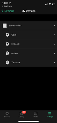

This is what I have in my phone, I can't even select my camera.

Support is not under help in the iOS (and I'm not actually seeing "help" as a choice there). What app version are you using?
This page shows under Settings --> Support
I am using the 3.7.1 version from 4th of Oct 2022
