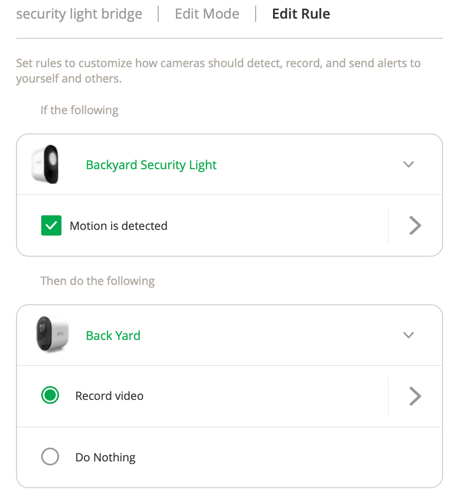

I have programmed my Arlo Security Light to start recording on my Arlo Ultra camera if motion is detected; however it is not working. I have two different security lights and cameras for the front and back yard setup this way, but neither works.
I just tested this tonight. If i walk in front of the security light, the motion sensor triggers and the light turns on. I then check a few minutes later (even later) and there is no video in the video library for the this event. I do notice the camera light comes on upon triggering the security light.. but it apparently is not recording.
I have attached a screen shot showing the settings for the security light. I have added the device for the Front Yard camera, and set this to record. I have done this same setting for my backyard security light and camera as well. Same result. Please take note that the motion sensor is triggering because the light comes on, so this is not an issue with the motion sensitivity setting.

See attached screenshot.. by deleting the mode, do you mean simply unchecking 'motion is detected' and changing 'record' option to 'do nothing' ?

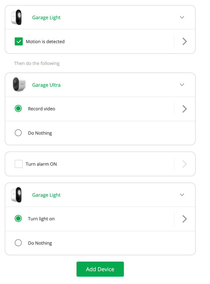

Have a similar problem. I set the Arlo Ultro to start recording video when the Arlo light detects motion. When the Arlo Light triggers, the Arlo Ultra actually also starts recording. However, the recording is not saved up on the Cloud, but appears to be only saved locally as I looked at the uSD Card and saw the video there. Uploaded my rule.

I have the Arlo light set with cross trigger on cameras. The lights will detect motion and turn on the cameras but the lights themselves do not come on. This is at night. Is this normal? Is there a rule or something I have missed?
When I turn off the cross trigger rule and just arm the lights they come on with motion detection.
I get push notifications either way.
I would try and rebuild new custom modes.... make sure the Light On is the first choice for motion and add the cameras as a second device.
It may also help to see your mode flow.
I have tried exactly what you said in your post I rebuilt the mode at your advice. The light turns. the camera will not record in the app the camera the areas are yellow stating motion but nothing is recorded to the camera. The library remains empty
