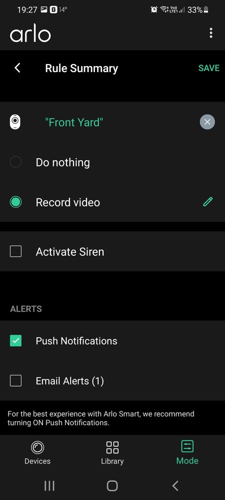

Post a screenshot of your rule so we can see.
Your pictures show the rear camera cross-triggering the front - is that correct since you mentioned the reverse? If you want the front to trigger the rear camera, you need a different rule which starts with the front camera and the adding the rear to the rule.
That said, there seems to have been issues with cross-triggering although I don't know whether it was an Arlo or user thing. Are the cameras connected to a hub or to WiFi?
