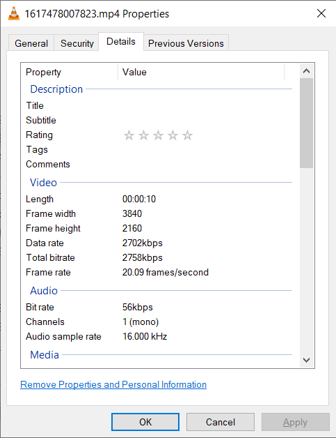

Did you try downloading a motion recording, and checking the resolution? That would let you know if the label was simply missing (or wrong if it says 2K), or if the resolution was in fact wrong.
With Windows 10, you can right-click on the downloaded video, select properties and then details.
1080p should say 1920x1072, 2K should say 2560x1440.

1. I've downloaded 2 clips off the cloud recording on my iPhone.
2. First recording has a 4k logo which was motion detected on the first day of purchase. Resolution is 3840 x 2160. (4k)
3. Second recoding has no 4k or 2k logo which was motion detected today. Resolution is 2608 x 1472. (2k)
btw you're correct that manual recording only has a resolution of 1920 x 1072 (1080p)
