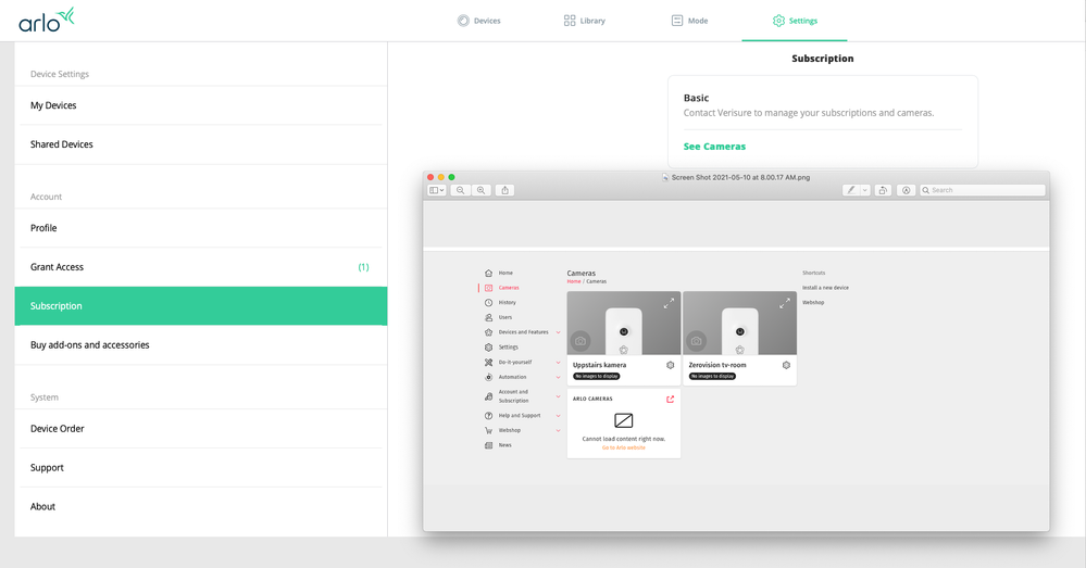

Hello,
I have Verisure security system at home, so I tried to connect the Arlo with Verisure, but along the way while I was trying to authenticate both accounts something went wrong, and hence I lost all my recordings, and can not access the Arlo from the Verisure pages, I tried contacting verisure and they said they can not see my Arlo account and on Arlo page it says check with Verisure.
Based on the above I've lost my motion detection and smart notifications, recordings all major functionalities from the Arlo Ultra 2
Can you please help on how to revoke this access so I can go back to control everything from the Arlo application and live a happy life.
