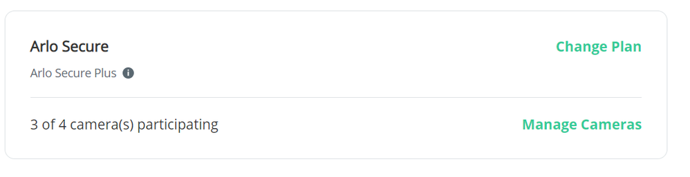

Arlo Secure plus plan says 3 of 4 cameras participating
MY Arlo Secure plus plan says 3 of 4 cameras participating. How can i change this. All four of my cameras are activated.

See Capture
Click on (or touch) "manage cameras". You should see the 4th camera in a "no plan" list. You can then drag it into the subscription list for the multicamera plan.
Note that if the camera is still on the trial subscription, you need to cancel the trial before you can put the camera on the main subscription.
