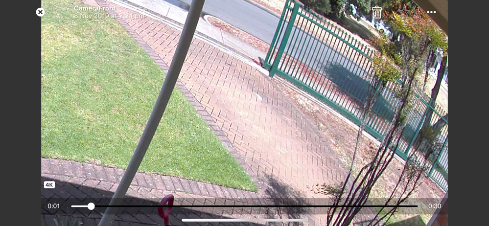

Top image is before PVR subscription
Bottom image is after PVR subscription.
Both images were taken with no other changes other than 30 minutes of time had lapsed between the.
Both images have been zoomed in and are at the far end of the view angle of the camera.
@Ks5134 wrote:
I’m not able to see the images.
They need to be reviewed by a mod and released - so there is a lag. You should be able to see them now.
