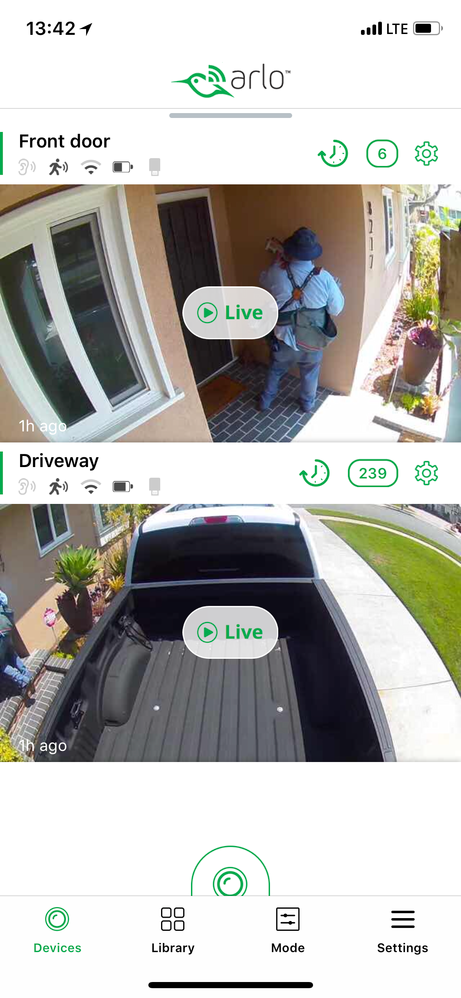

IMG_1254.PNGstuck on this and the bridge light just turns off after 15 seconds
