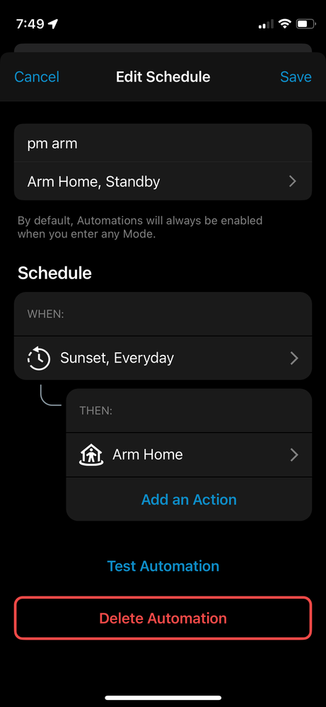

First set up "Arm Home" and "Arm Away" identically - both need to arm all the cameras (including the Go 2). Also modify "Standby" to arm the Go 2, so it will not be disarmed with the other cameras. This should be useful as a guide when making those changes:
Then you set up a schedule automation that switches to "Standby" every morning at 5:30, and set up a second automation that switches to "Arm Home" at 11pm. These automations need to be enabled whenever the system is in Arm Home or Standby (and NOT enabled when the system is in Arm Away). They should look like this (substituting your times for sunrise and sunset).
Finally you need to set up two geofencing automations ("Arrive" and "Leave"). "Arrive" is only enabled when the system is in "Arm Away" mode - that ensures it only runs when the first person arrives home. It is safe to enable "Leave" in all modes. These will work w/o modification:
Note that "Arrive" will always switch the mode to "Standby" - even if you arrive home after 11 pm. In that situation you need to manually set the system to "Arm Home". If you forget, the system will remain in "Standby" until 11 pm the following evening.
As far as the Go 2 goes, I suggest using the on/off control in the camera settings to arm/disarm the camera. The only other way is to modify the three modes to remove the rule, and then put the rule back when you want to re-arm it. Which is tedious.
The other option would be to create a separate location for the Go 2 in the app. Then you'd have independent "Arm Away", "Arm Home", and "Standby" modes for that camera, and you would also be able to geofence it (using its location as the anchor). The downside is that you'd need a separate Arlo Secure subscription for the camera (because you need separate subscriptions for each location).
