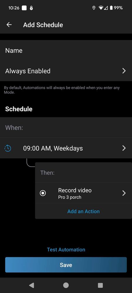

You don't always have to change a mode. As I mentioned in post #9 here, rather than selecting Change Mode when adding an action, try using Record a Video which then allows you to pick a single camera to work with. You can have multiple schedules to accomplish a general setting as well as specific ones.

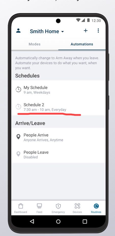

Hopefully these screenshots help. Note what is selected in the various screens.  If not, perhaps you need to talk to a friend/neighbor to see if they can figure it out.
