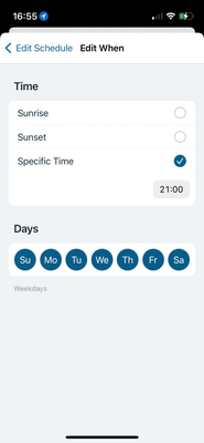

It’s odd though because there are no end times - I set 9pm under the ‘specific time’ label in the app, but I cannot input 11:59pm, then?
Here’s what I have in the app - as you can see there is no ‘end time’…

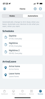

Following up here…
I created the following schedule, but it still didn’t work. The alarm did not automatically change to Standby at 7am.

By the way, does anyone know what this ‘Always Enabled’ setting means? I’ve read it 10 times and can’t figure out what it means.
It seems like Always Enabled simply means that you can select them. Not sure why you may want to disable any but...

I have the same exact problem. My schedule enables home mode at 10pm but my schedule to enable standby mode at 5am doesn’t work. I’ve deleted it and recreated it and it still doesn’t work. The old interface I had to create a schedule that showed 10pm to 11:59pm “home” then another 12am to 5am “home” then one for “standby” from 5:01am to 9:59pm. This new interface doesn’t provide a start and stop time. The programmers for the application are simply awful. How they can make great hardware and have such a horribly buggy application is beyond me. Do they not use their own software?
The 4.x UI schedule does work overnight BUT one thing I've found is that picking the exact hour at night has an issue. My nighttime mode was scheduled to switch at 11:00PM but wouldn't work. After trying various things, I tried setting it for 11:01 and 10:59 - both worked fine.
Okay, programmatically it makes no sense to me but I did as jguerdat suggested and changed the "awake" time to 5:01 and now both "Sleep" and "Awake" schedules work. I've tried everything to get the Awake schedule to work but this change seems to have fixed it including changing the time to 6:00am but that didn't work either. It's weird that the Sleep scheduled is set to 10:00 and it has always worked to arm my system but the 5:00 schedule would not change the mode to Standby no matter what I tried. Changing the time to 5:01 and now it works. Anyway, thanks jguerdat for the insight I would have never considered. Now if I could get it to not notify every Apple device in my house that it's changed the mode to standby I would be in at peace.
