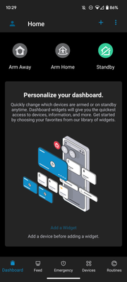

There are two user interfaces in the current app. One shows "Feed" and "Dashboard", the other shows "Library". "Library" is being phased out - eventually everyone will be running "Feed".
In the meantime, the "friend" account feature only works if both accounts are using the same interface. If they are mismatched, you need to migrate the account using "Library" to "Feed". Note this cannot be undone - once you are running "Feed", there is no going back to "Library".
You migrate the account using "Library" by going into "add device", and then starting to add a Pro 5s camera (or alternatively a home security system). You can't complete this process, since you don't have the the camera. But you will end running "Feed".
The app notified me there was a newer version so I went ahead and updated it. His login is different than mine. I am a "allowed user." When I sign using his user name and password it will sign him off on his device. His home screen looks different than mine now. No, I don't have access to any library. I age tried adding the devices and it just searches forever... never locating anything. If I click on "feed" it is a blank page.
