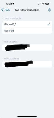

I found the clutter of old devices with old phone names in privacy (took community posts to find that) and in automations for arrive/leave. I deleted the lot of them thinking at least my device I was using would remain. It is listed in privacy, but never was in the automation screen. So after deleting what I could in privacy, I now have no devices. I set up a separate account on another phone and invited that one to join the first. That device doesn't show in privacy or automations. I logged into my first (primary) account with the second device and recorded to trust it. Still not showing in automations or privacy, but does under two-step authentication.
The device names and list of devices in two-step authentication do not match up to those that were/are in privacy/automations. They are separate lists. Support was having me work on trusted devices thinking they would show up, but that process doesn't work since they are clearly separate things. What is missing is an onboarding process (that works) for devices into the privacy area and sync that to automations for use. No doubt a missed use case and/or bug.
