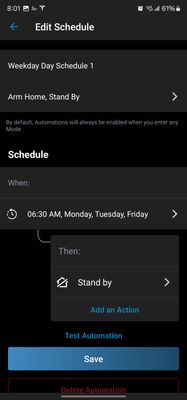

I have set up four automations in my Arlo Secure app:
Weekend Day Schedule: Starts at 8 AM on weekends and sets the mode to Standby.
Weekday Day Schedule 1: Starts at 6:30 AM on Mondays, Tuesdays, and Fridays and sets the mode to Standby.
Weekday Day Schedule 2: Starts at 7:45 AM on Wednesdays and Thursdays and sets the mode to Standby.
Night Schedule: Starts at 10 PM every day and sets the mode to Arm Home.

Can you post screenshots of the various automations? (mask out the map in the geofencing ones).
Here are the screenshots of my automations. I've also attached a screenshot showing that Arm Home activates as scheduled, but switches to Arm Away at 11 PM.
Thx. Your automations all look correct, so this is confusing.
