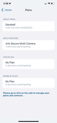

This is my only option and coils not click on the plan to add camera it just highlighted the words.
It appears that you have 1 trial sub and a paid sub - is that true? The camera(s) in the trial plan can't be added to the paid one unless you cancel the trial. What shows up in each selection when you click on them?
I already canceled the trial on the 2 cameras that I tried to add to my subscription but could not. Right now I could not click on my subscription plan. The link is dead and it’s only highlight the words. Talking to support they said it’s a new issue from the recent update so they are still trying to fix it.

The cameras are in my app. I have 3 cameras and a door bell. The bell is currently on a trial and I am afraid to remove it so I can switch over. The 3 camera I was able to add one to the subscription when I activated the subscription plan. After that I added 2 cameras to my app and I can see them in the app but I have no way to add them to the subscription. You can see from the screenshots attached here. They don’t show up in Arlo Secure for me to drag them into the plan like I did with the first one.

Looks like you don’t need to worry about adding manually anymore with the new plans. The cameras will be automatically added if you already have a Secure plan. If you already have a camera running and then you buy the plan, then just remove and re-add the camera. This is what I did with tech support. For sure, the KB articles need to be updated clearly as I could not find this information anywhere.
This is currently functioning by design. The camera(s) should be added automatically to the appropriate plan when they trial plan expires.
