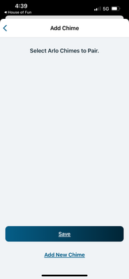

Ever since updating to the new arlo software my chime 2 stopped working, I reset it, removed and re-added it, it’s connected and online in arlo app but when I try to pair it to my audio doorbell OR my essential wireless video doorbell I click +add chime and nothing/no devices are displayed for me to click on and save. Customer support was no help whatsoever, can anyone help me?

I have reset all of my devices including smart hub, we recently had a power outage and when it was restored the arlo new update message popped up so I updated it and ever since my chime originally would not connect, but that was Telstra modem issues so once I sorted that I fixed it and re added it but now every time I try to pair it with the doorbell it’s not listed even though it’s clearly there in my devices??……
It's not clear to me what you're doing to pair the chime with the doorbell. You need to use the DOORBELL settings to choose the chime. Is that what you're doing?

It shows me clicking on the doorbell, scrolling down to pair chime and then when I click that no chime is available at all there’s nothing for me to click on! I don’t understand how your not seeing what I’m saying
