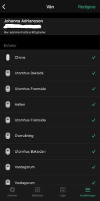

I invited my wife to create an account and granted her access to all cameras. She has Administrator rights according to the app (see attached image).
”Har administratörsrättigheter” = Has admin rights.

I did notice that she has no edit button on the geofencing mode. It just feels that she has no rights to change modes or something. See image attached here.
This screenshot was made when I had activated my ”god natt” mode so that had nothing to do with it 🙂
Your screenshot seems to show the old user interface (UI) that uses Library to view recordings - is that correct? If so, here's a link that tells you what a guest account can access:
