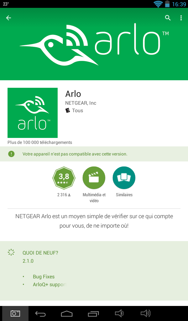

"Are you saying you are not able to install the update on the tablet running Android 4.2? Do you get any error messages?"
EXACT, it tell me version is incompatible with my device...check the picture and use Google Translator to understand 😛
 Android Version
AND if I install the new version on my newest tablet than I use less (because only 7 inches, I use my 10 inches tablet with 4.2.2 version all day) It make my ARLO Q to crash as soon as  I use the New application...I Have to take out the new application , reset tha camera ans reinstall oldest application to make the ARLO Q to work again..I Talk about 7 hours with 3 differents technicians at your technical support to try to explain that to them...English isn't my first langange...I use Google translator to talk with them by phone...It is painful for me to try explaining technicals difficulty...BUT no Phone  French support in Canada ; 😛
