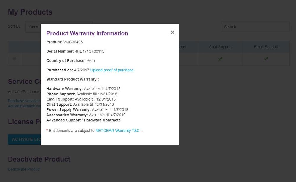

erondon
my camera has warranty, It was bought by Amazon USA, it has two years warranty and failure in a year.
So, do I need to send the product to Amazon or to Netgear US?
GUess I don't understand the warranty specifics. Some countries get a 2 year Arlo warranty, most get one year. WHat country are you in and where did you buy the camera? The place of purchase sets your warranty.
In any event, unless the store (Amazon) has a warranty of its own, you would need to use the Contact Support link at the bottom here and again on the new page to get to the page with phone and chat options to be able to open a case. They will step you through the process of whether you're covered and how to get an RMA.
