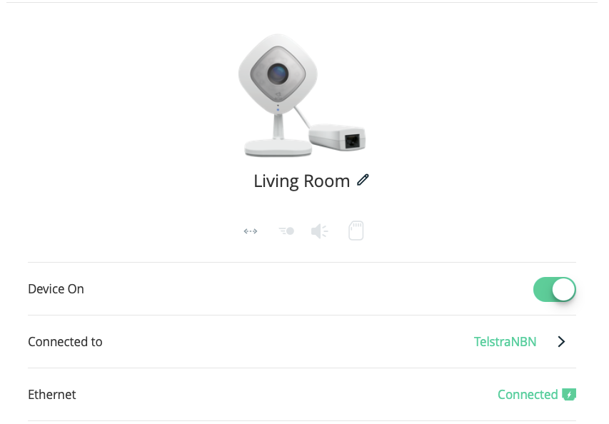

TandC
Telstra NBN is my modem and wifi, but it shows connected via ethernet/POE
