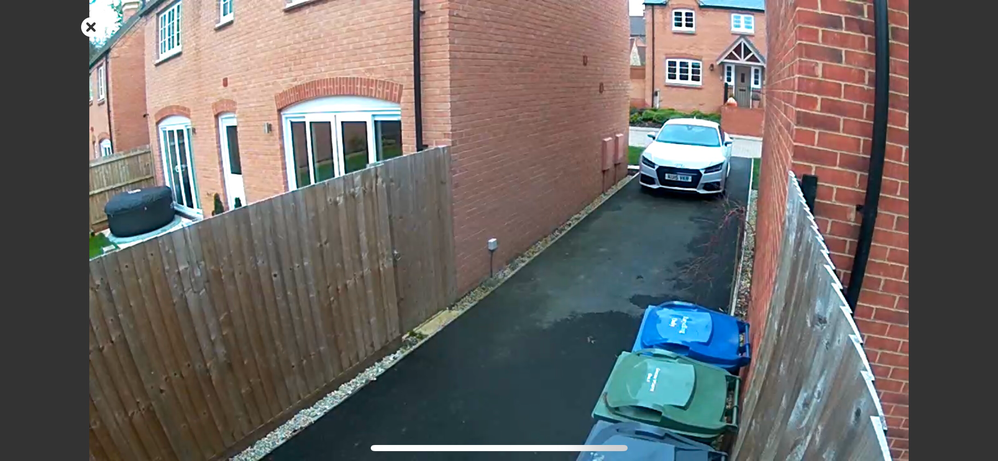

Richard_abra
Hi all help required with an Arlo pro. What’s the expected range in motion detection? I have my garage camera set up and works great but won’t detect unless very close to the garage. For example someone could walk half way down my drive way and it does pick you up or I can park my car at the end and again it doesn’t detect anything. Sensitivity on 100% . Any help would be appreciated!

Richard_abra
Thank you for your reply.
In motion test the light flashes and it detects motion all the way up the drive way. Just dosnt work as it should when it’s monitoring itself.
Also I tried a test and moved the camera so that it’s facing the house more. Meaning walking down the drive would be walking across the camera more and the issue it worse! Very strange.
And you're setting the motion sensitivity in your modes and rules? The motion test is just a test and doesn't save.
Richard_abra
Thank you for your reply, i have 3 camera set on a schedule, it dosnt look like i can set modes and schedule at the same time?
You create as many modes as needed for specific needs and time periods. Then place them appropriately in the schedule. WHen you enable the sachedule, the modes are automatically selected so no, you don't use modes AND the schedule, just the schedule.
