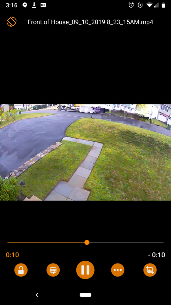

Recently I have noticed after the last couple of base firmware updates, that my cameras get glitchy video that always seems to occur at the 12 second mark on my recordings. If there is an object like a car or person in motion the video looks like it freezes or distorts and then picks up again after a couple of seconds. I tried rebooting the base but it isn't resolved. It happens on all 5 cameras. Any ideas?

As expected it appears the latest firmware (1.092.0.24_985) resolved my issue and my recordings are no longer getting the 10-12 second mark glitch I reported almost 2 months ago.
