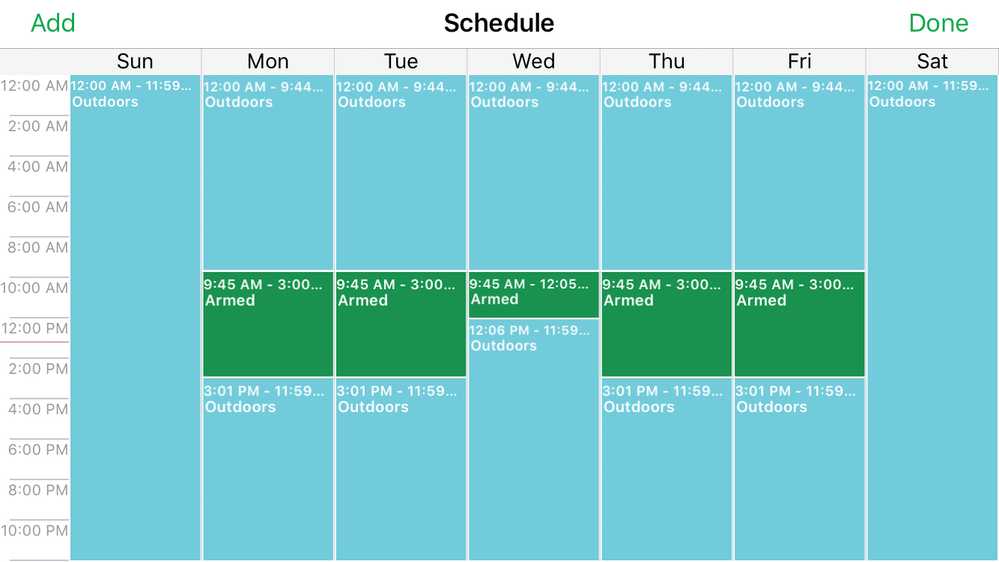

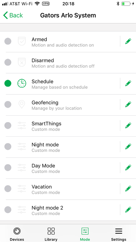

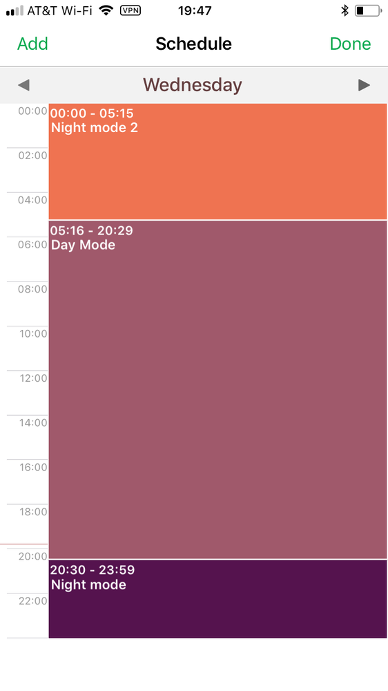

VioerGator,
Can you provide screenshots of what your schedules look like?

POSSIBLE TEMPORARY FIX TO SCHEDULING PROBLEM - (No more than two schedule changes per day)
I have two modes that I use with scheduling, DAY and NIGHT. During the day (0700-1900) I have all of the cameras set to a lower sensitivity. At night (1900-0700) the sensitivity increases and I also have notifications turned on so that I receive an email with any activity. That makes it easier to review motion events in the morning. I have attempted to set the schedule seven days a week with the following hours:
0000-0700 NIGHT
0700-1900 DAY
1900-2359 NIGHT
Every time midnight rolls around in that configuration the system is automatically disarmed. The hours of 0000-0700 are the hours where I need reliable coverage the most and having the cameras go into a disarmed state is simply not acceptable. I have found a workaround that is not ideal, but it seems to be getting me by for now. If I use the schedule 0000-0700 NIGHT and 0700-2359 DAY the system seems to stay armed as programmed through the night. My cameras are not as sensitive as I would like during the initial dark hours, but this is better than being disarmed altogether.
The hitch seems to appear when there are more than two changes per day. I hope this helps someone to pinpoint the problem by sharing this information. I have tried all other recommendations to include a full factory reset, redoing the schedule from scratch....EVERYTHING! None of the other suggestions worked to make the schedule function as it is supposed to.
