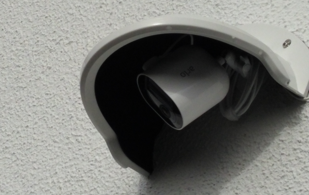

Sheltering the camera can help a lot with this. You need to stop raindrops running down the front surface of the camera or dripping right in front of it.
I have a Pro 3 tucked under a Hikvision DS-1250ZJ camera shelter (see attached). In this configuration, with the camera mounted upside down, it's rarely (if ever) activated by rain. This one is on a solar panel though, not plugged in. I have another Pro 3 which is wired for power, under the same kind of shelter but not mounted upside down and so is not as well sheltered. That one is activated by rain much more frequently. I think the difference may be due to the 'Foresight' feature. When plugged in the camera is always capturing video (just not uploading unless motion is detected) and that is maybe why that one records rain more frequently? Or maybe it's the way it's mounted - it might be that keeping the front surface of the camera dry is what prevents the motion sensor from activating. I can't tell.
