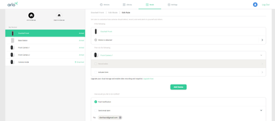

Hello all,
I have cancelled my cloud video recording subscriptions and want to do a local video recording to my Base Station (USB storage). I have checked my Base Station and it shows storage good but I dont see any video save in the library.
I did google and find out that you need to check record video box inside mode but as you can see, it is grey out. Please advise how to fix it. I have reboot, re-add but nothing seen to work.

Hello and yes I have vmb4540 model. So I eject the USB and check it on my PC. There is no video. Only arlo folder and nothing is it there
Your rule seems odd to me - you're using the doorbell to trigger a separate camera rather than the doorbell itself. Are you using the original doorbell without a camera? I would start by creating a new custom mode and add a new rule to see if that helps. If using a doorbell with camera, use that as the recording device and maybe add the other camera as an addition to the rule.
