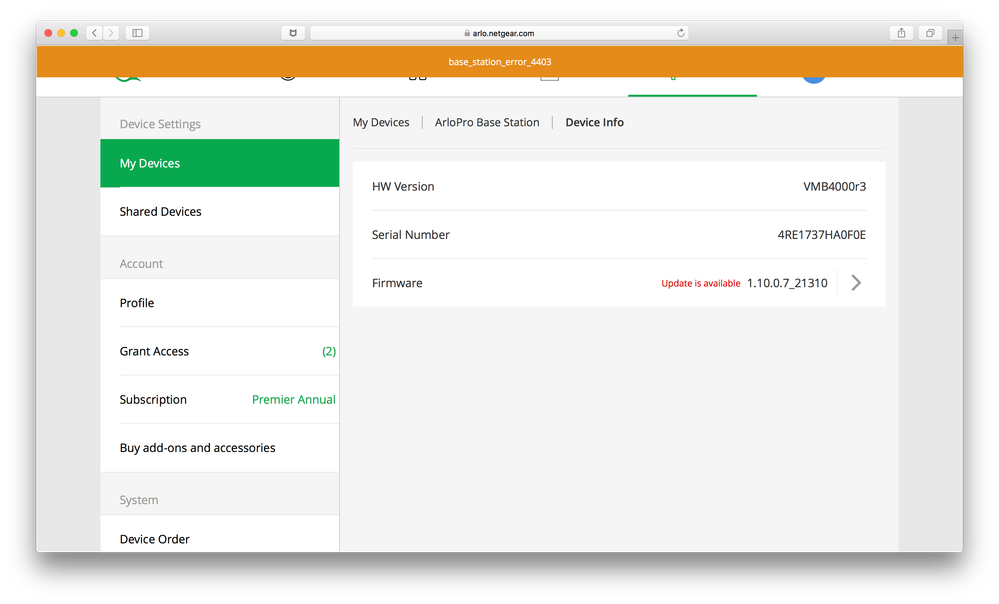

Hi - this latest ARLO PRO Update is VERY VERY FRUSTRATING
I have tried everything - Update via the mobile app on iOS and also on the web browser and both attempts have failed!!!!
Attached is the error message from the web browser.
What can be done?????
Check your system's settings on firewall, antivirus or vpn and make sure you allow Arlo... That's odd that even web is not letting you download..
