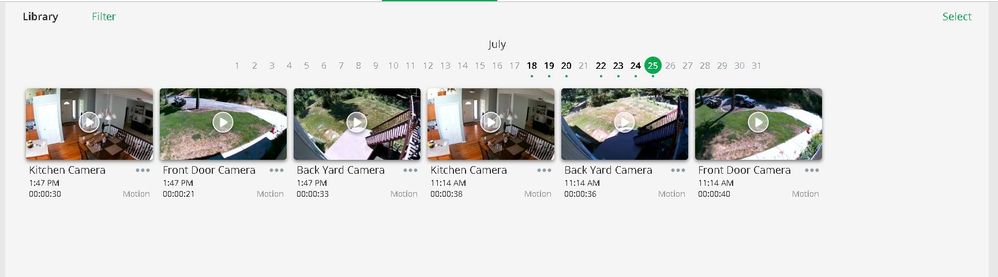

I have been using the Arlo Pro system for a while now. I have three cameras linked to the base station. Front Yard, Kitchen, and Back Yard. I have had them set up to record for a set lenght of time on movment individually. That lenght of time is 2 minutes. Everything worked well for the first few months. Then, recently, if one camera detected motion, they all recorded for random amounts of time. I would get notified that "Front Yard Camera has detected motion." but the library will show all cameras at that time for times ranging from a few seconds to 2 minutes.
My settings have not changed. I verified that if Camera 1 dectctes, camera 1 records for two minutes. and so on. But that is NOT be behavior it is exhibiting. What it is doing is if Camera 1 dectects, camera 1 records for 23 seconds; camera 2 records for 34 seconds, camera 3 records for 10 seconds.

Sure here they are. I am only showing the one for the front door camera and todays library. Two events where all three cameras recorded for different times. It is pretty simple: Front door detectes motion, records for 120 seconds. But that is not what is happening. Thank you!!

After testing it, it is showing the same exact behavior as before. Nothing has changed. All cameras record for a few seconds at the same time. I do get notified of which camera saw the motion, but all cameras record.
