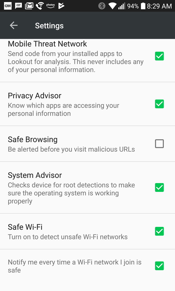

Two days ago when trying to view library files on my LG V20 Android smartphone with Android v 7.0, The files would only play for up to 6 seconds then freeze and the buffer icon would display, The files would not play beyond that point of where playback froze. " V2.5.1._21471" Error ER081 Unable to Connect"
In troubleshooting, I found that the Lookout Premium App which had an new update, "v10.22-5091e54" is causing the problem.
I resolved the problem by un checking the Lookout settings box for "Safe Browsing - Be alerted before you visit malicious URLs". Now all Arlo library files on the Android smart phone play from start to end with no buffering or other problems.
